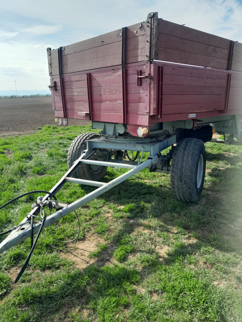

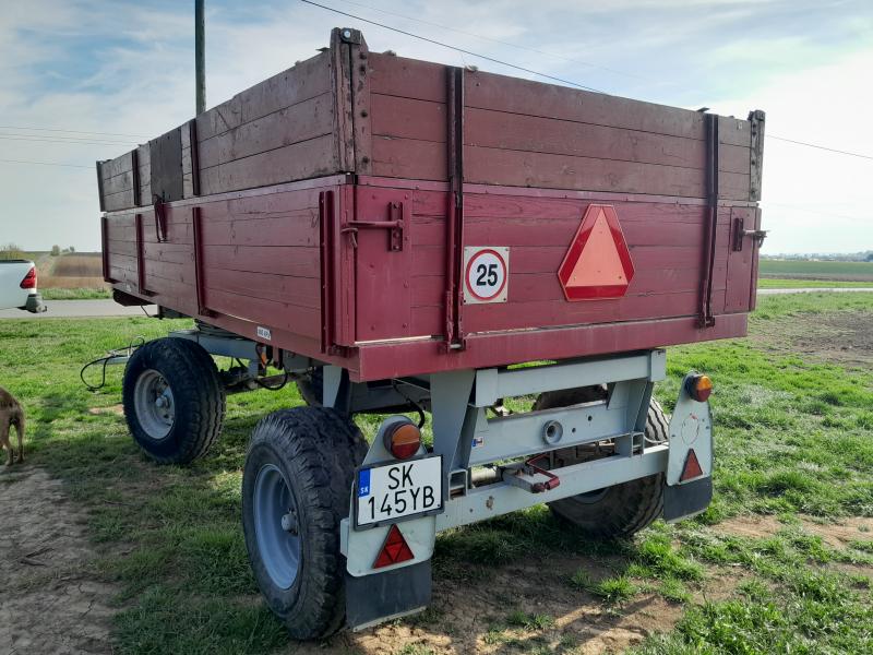

#501 rtamas1976
2026-04-11 05:01:39
Hazaért!
