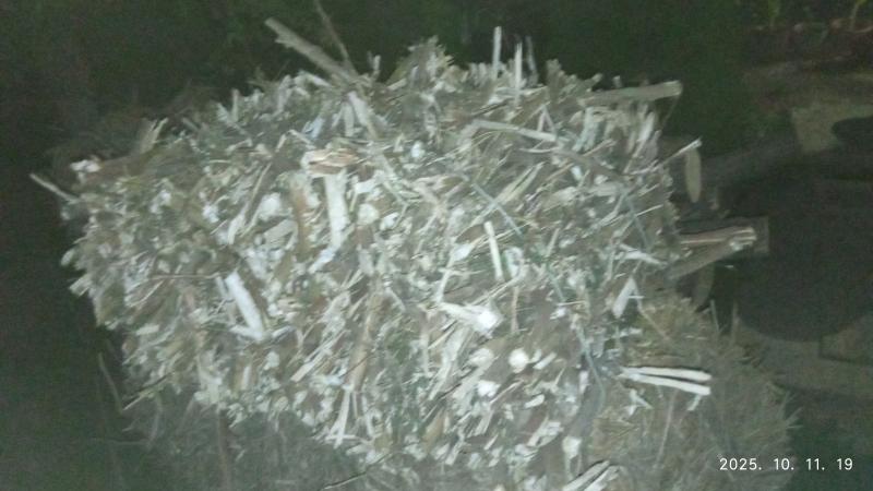

#535 mtz1221
2025-10-11 19:44:44
smile sweatdrop
